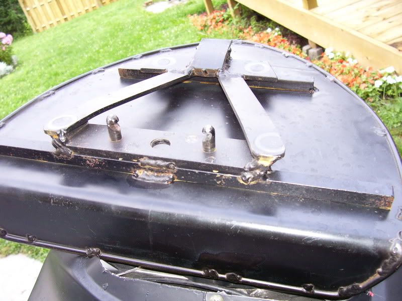

    Drill the chopping board to fit the rack.
    Rack on board
    The clips I used hold the rack off the board high enough for the loop clips on the bag to go around the bar to secure it.
    Drill the chopping board and the donor pillion seat base
    Mount the chopping board to the seat base. I was going to get rid of the foam and use spacers to mount the board, but after mucking around with it I decided to leave the foam and put the cover back on (I shouldn't have removed it ) By using ny-loc nuts I can pre-tension the bolts a bit and put some pressure on the foam, but the foam will still act as a shock aborber when the bag has some weight in it, it's probably kinder to the bike too, I can't have my socks and jocks shacken up too much. The nuts won't come undone.)
    Clip the donor seat onto the bike and instant ghetto rack

            I hope so. We'll see.
            The most torture it will get is under heavy braking. Cornering and acceleration shouldn't be too bad.
            Cornering ther will be some force trying to throw it off and some pushing it down. Acceleration the latch will have to cope with being tugged at. Braking is when the rear tab will have to do some work.

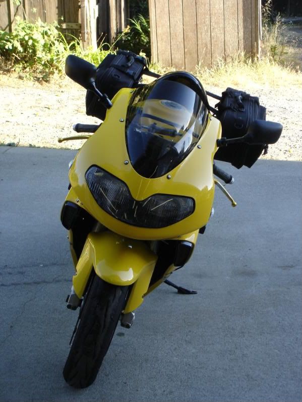

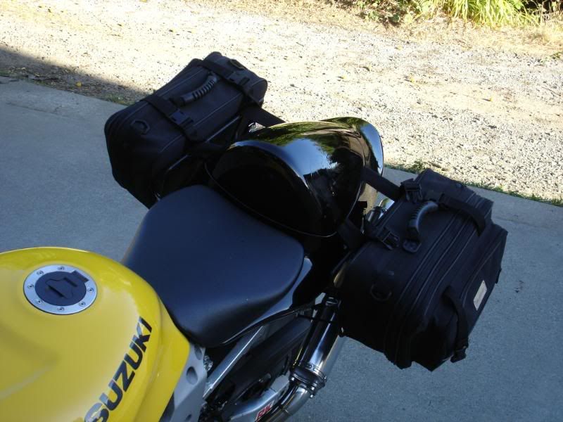

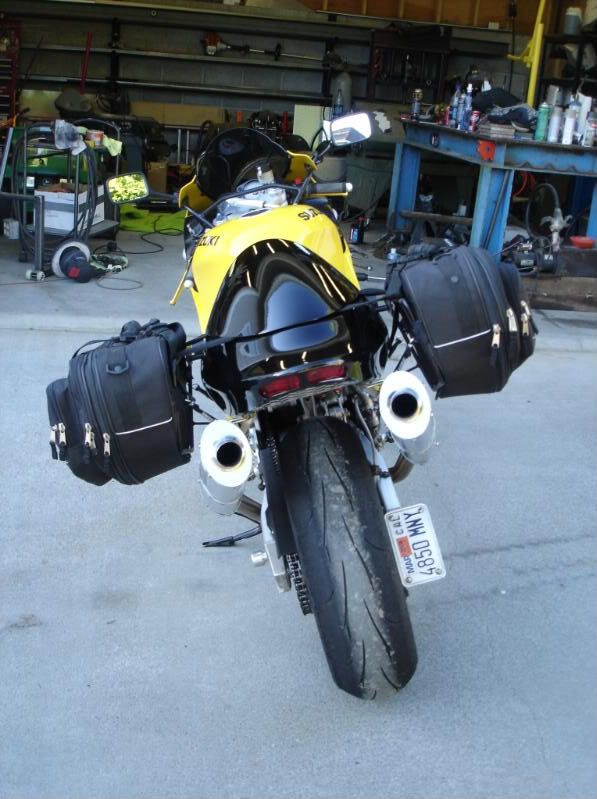

                          i figured since it was an R, it wouldn't seem that much wider. it makes splitting traffic a little more difficult, but its not bad. i made the racks out of 1/4" steel round stock. (before i could weld aluminum) they use the stock bolts that hols the rear plastics on and each have teo legs that rest in the tiedown hooks/loops on the bottom of the subframe. they're actually pretty strong. here it is from the front.
                          going to make some out of aluminum when i get some free time. i'm puting the finishing touches on a m/c trailer at the moment.

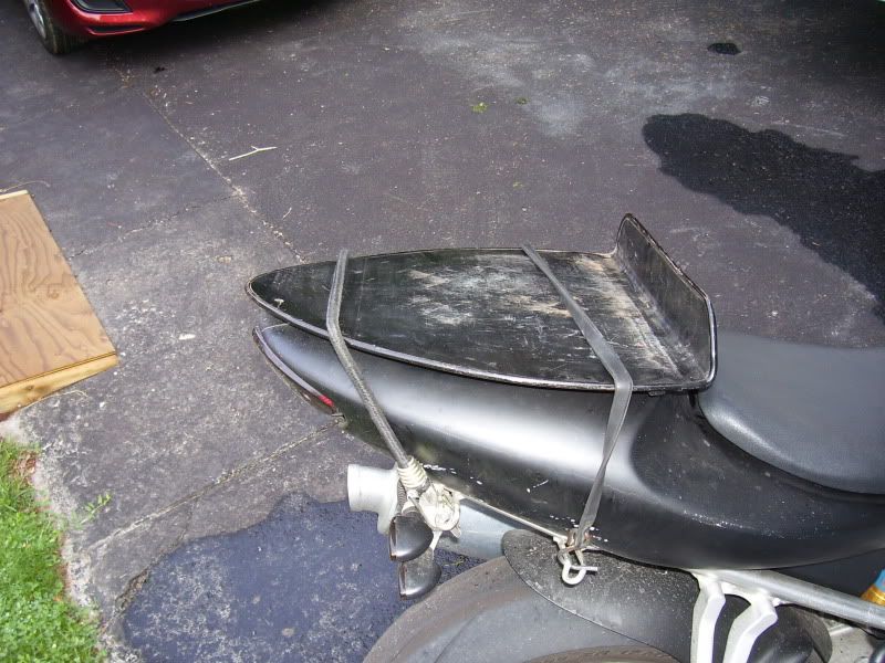

                              Here's what I did. The bungees are just there for use they don't hold it down.
                              I imitated the mounting and lock points so that it clicks in like the stock seat or cowl.
