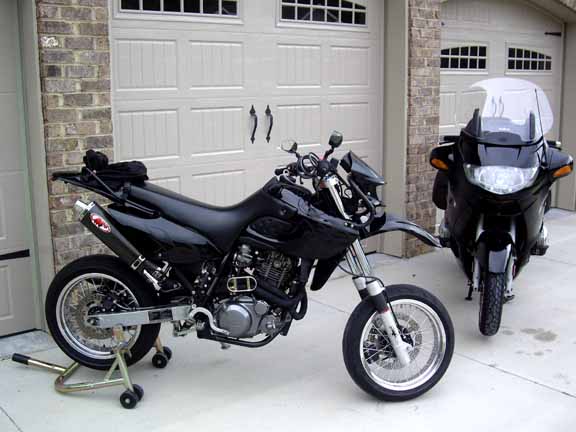

ZX12 any year will go on the front and they are gold
1000 rear fits but fronts won't ....he's a moron and withdraw because of that reason
Here is mine with 1000 rear and ZX12 fronts
