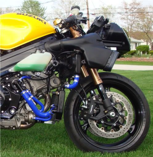

        The 08's fit right into the stock TL triples. A little sanding on the lower triple allowed the busa forks to slide right in. I did obtain the Busa wheel and axle also. No shimming or mods required for that wheel.
        Since the pic I did install 08 R6 calipers and lines.

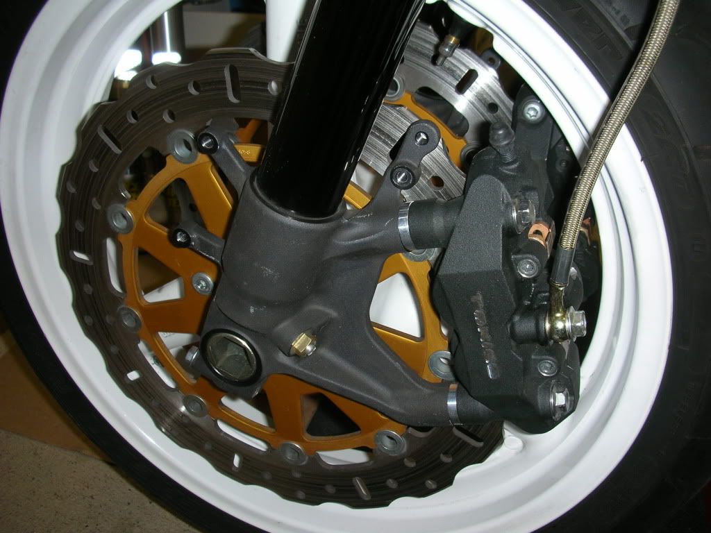

          Installed '09 Busa forks and calipers in TLR clamps and kept the TLR wheel. As Vandriver said, this combo needs caliper and rotor spacers and the Busa axle. Also added a late model GSXR Nissin radial MC too, because I like the action.

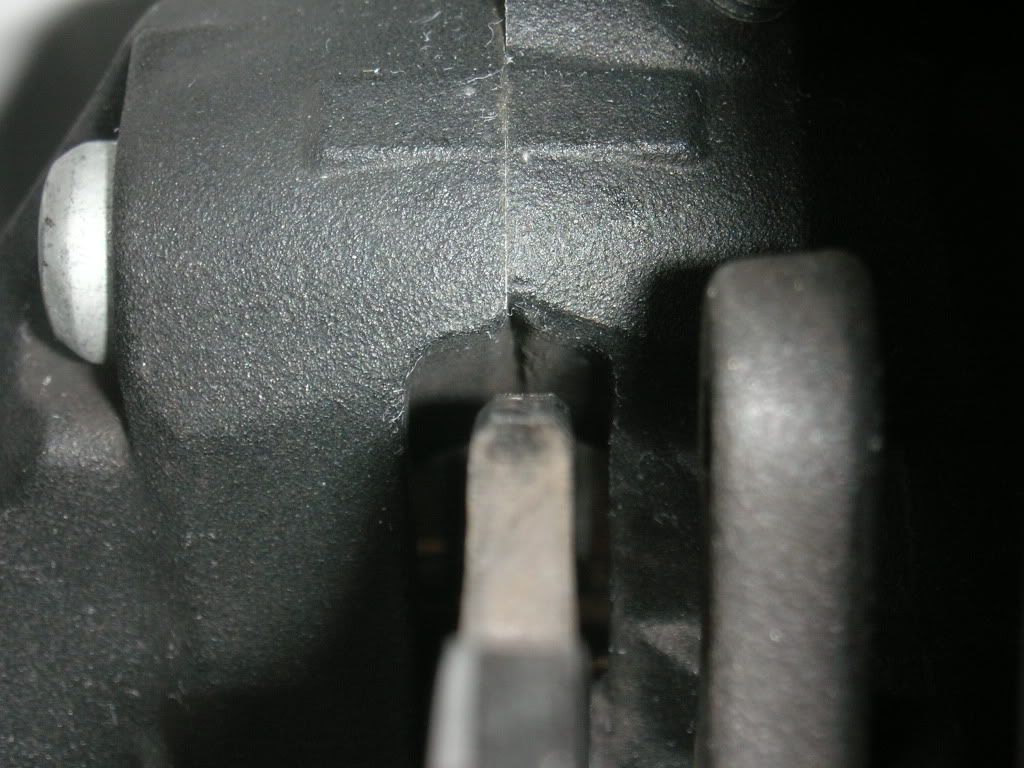

          Rotor is centered in caliper

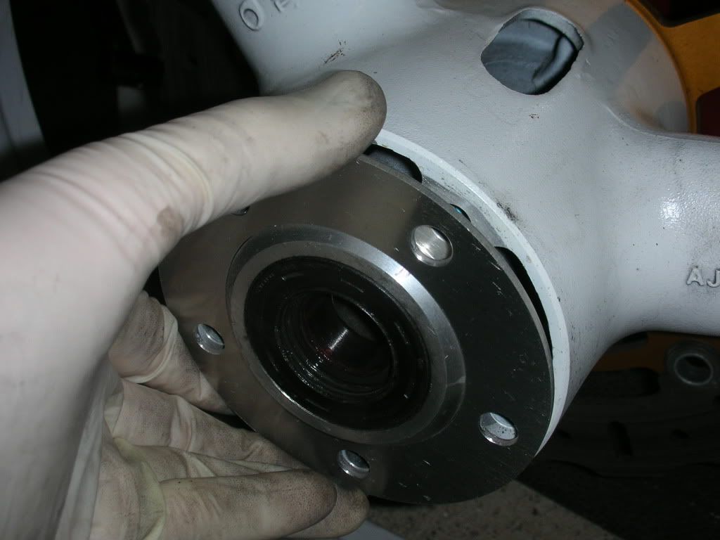

          Rotor spacer

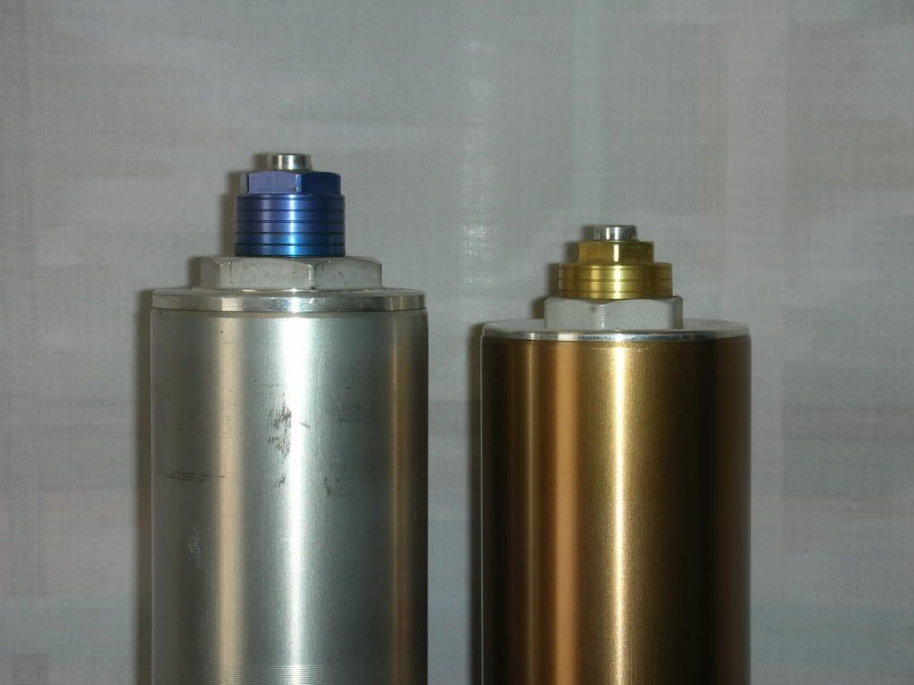

          TLR & Busa (bronze) forks. Slight height difference.
