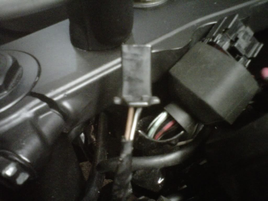

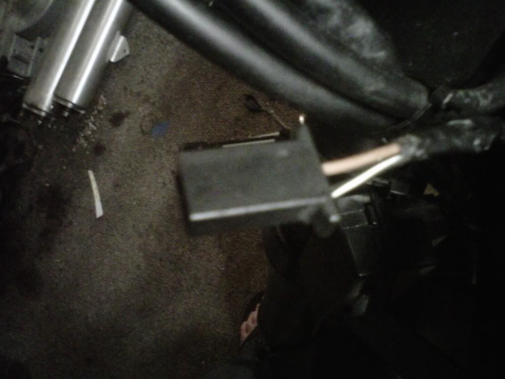

    hints black male connector
    black wire w/ white tracer
    brown wire
    can be found on the front of a 2001 TLS

    The unused park light connector

        aka... fused/switched unused power supply.. I spliced into mine and added running lights for better day/night saftey

                actually for what is called a "City Light" that goes into the bottom of the headlight assembly....used in Non-USA bikes....but not mine....I got a factory Zukkie projector headlight assembly and then found a salvage yard in britian that had a City Light that was like new to install in my headlight assembly....even got the hand controls that have the Non-USA headlight switches with running light position....USA bikes do not have that as you may know....and has the "flash to pass' button on the left side controls....all plug and play.....hope that helps
