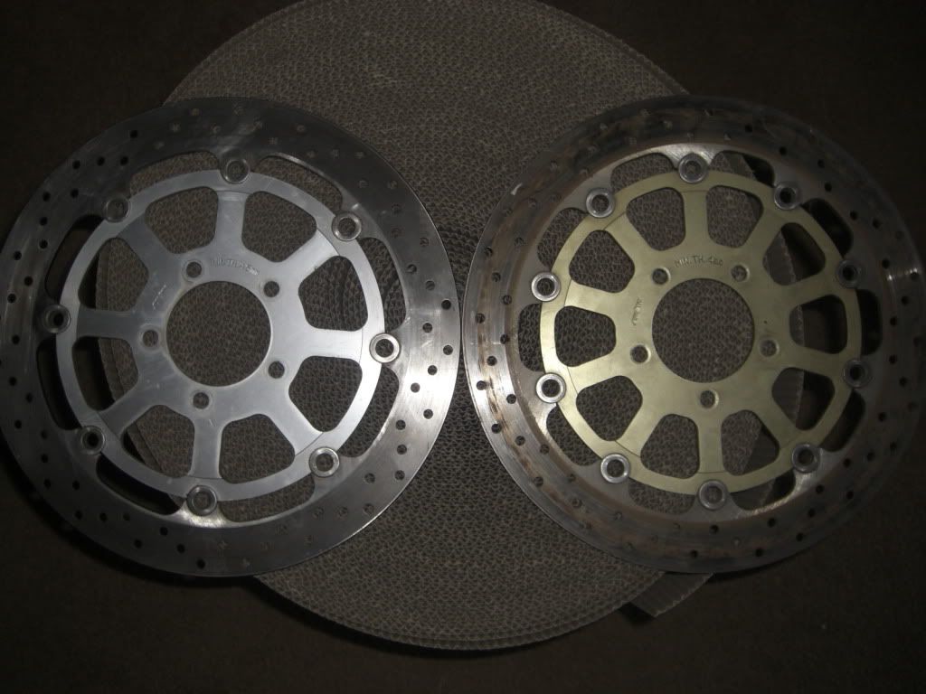

                      Well my info only comes from my personal experience. But that tell me that my friends gsxr rotors also say 4.5mm min thickness that my tlr says. This goes for both the factory rotors that were on both of the bikes as well as the rotors we've replaced them with. I know his calipers work on the tlr because I borrowed them to see if I had a sticking piston in one of the calipers. I can't say for sure that from the factory the starting thickness is the same, but why would Suzuki use the same diameter rotor with the same min thickness and calipers, same zero offset and have them start out with a different thickness. To me that just doesn't add up.

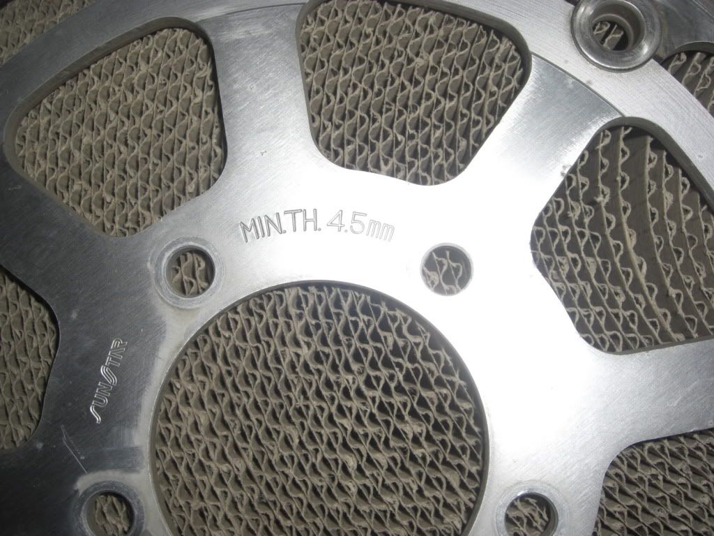

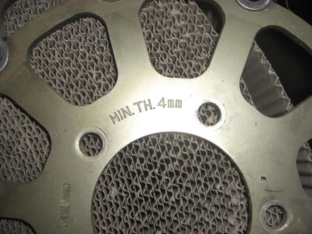

                      TL on the left, 8 buttons from carrier to rotor surface, min thickness 4.5mm.
                      GSXR SRAD on the right, 10 buttons from carrier to rotor surface, min thickness 4.mm.
                      TL.
                      GSXR SRAD.
