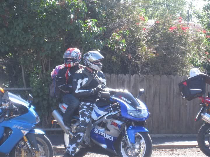

No issues here...
<a href="http://s364.photobucket.com/albums/oo83/jlhowser/?action=view¤t=DSCN3432.jpg" target="_blank"><img src="http://i364.photobucket.com/albums/oo83/jlhowser/DSCN3432.jpg" border="0" alt="Photobucket"></a>
<a href="http://s364.photobucket.com/albums/oo83/jlhowser/?action=view¤t=DSCN3430.jpg" target="_blank"><img src="http://i364.photobucket.com/albums/oo83/jlhowser/DSCN3430.jpg" border="0" alt="Photobucket"></a>
<a href="http://s364.photobucket.com/albums/oo83/jlhowser/?action=view¤t=DSCN3423.jpg" target="_blank"><img src="http://i364.photobucket.com/albums/oo83/jlhowser/DSCN3423.jpg" border="0" alt="Photobucket"></a>
<a href="http://s364.photobucket.com/albums/oo83/jlhowser/?action=view¤t=DSCN3385.jpg" target="_blank"><img src="http://i364.photobucket.com/albums/oo83/jlhowser/DSCN3385.jpg" border="0" alt="Photobucket"></a>
