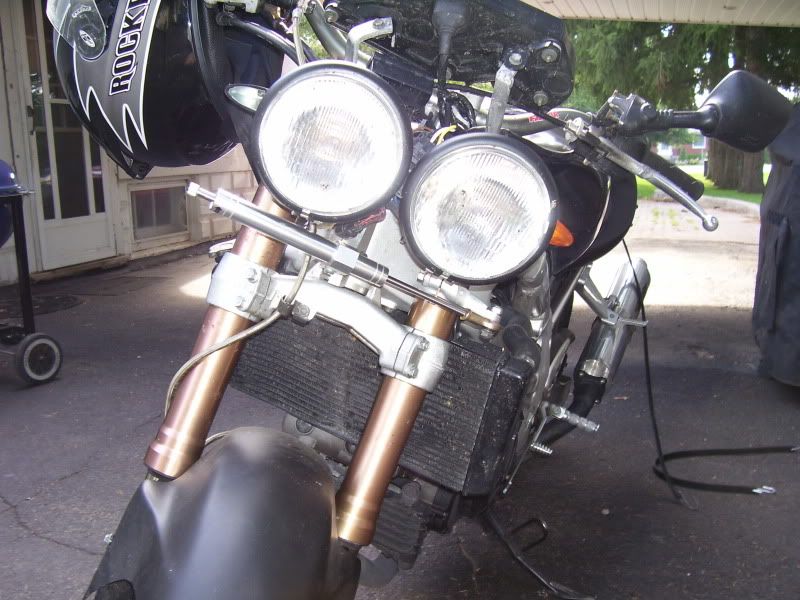

Finally got the steering dampener moved
  • Finally got the steering dampener moved

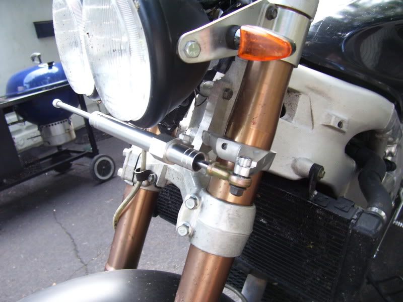

    Used to have a goofy position for the dampener but it was quick to mount and I got to go ride
    Finally got around to moving it so I could put the duct for the ram air back on soon.

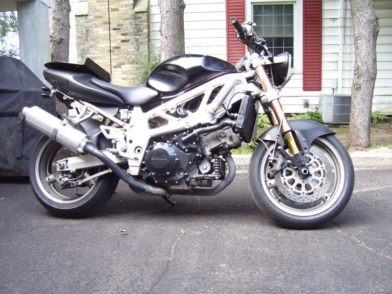

      Re: Finally got the steering dampener moved
      nice work.
      you can mount the fuse box on a little bracket on the bottom triple on the brake line mount and the excess wiring will tuck inside the frame in front of the airbox

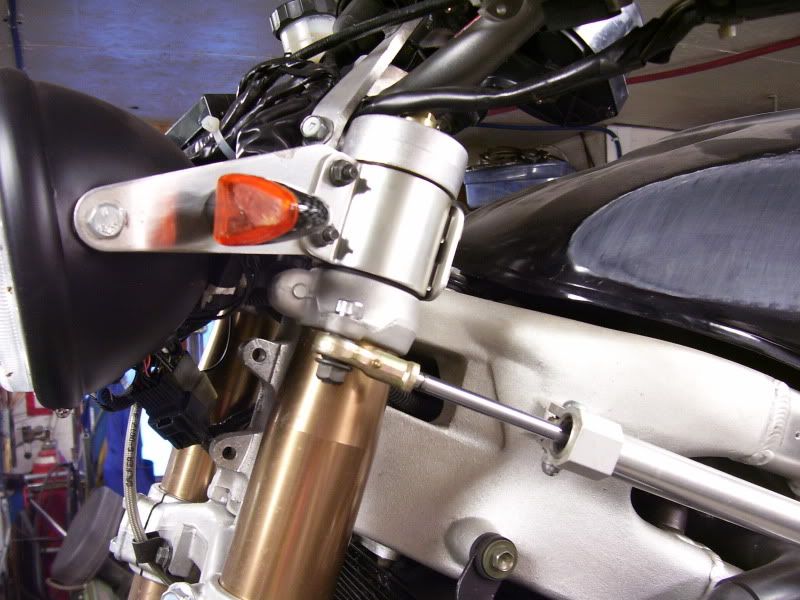

        it is actually the top half of the one side of the bottom of a spare triple tree.

          You're being kind, its a hack job at best. I only used the band saw and belt sander. I should have been shaping on the mill to do it nicely.
