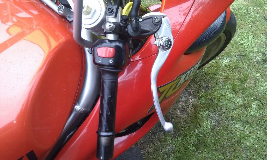

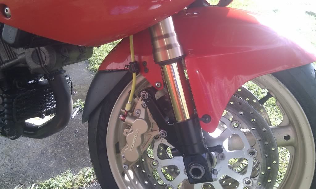

          Re: Really good brakes
          As you can see by the photos the master sits right along the bar but the lever is long so is comfy on the hand, the double banjo is tight but if you used a single line set up with one over line over the fender it would fit with room, the only PITA was you had to remove the brake switch connect up the wires then put it back on as it was near impossible to get your fingers in to connect the wires while switch was fitted

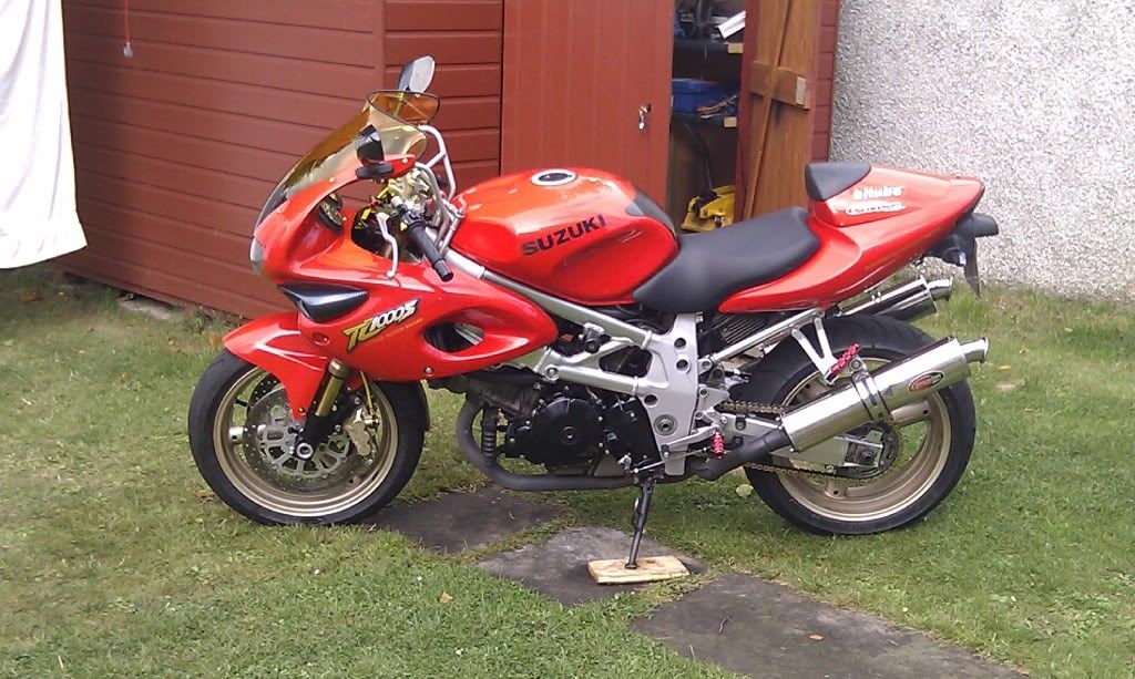

            Just a wee look at my busa forks

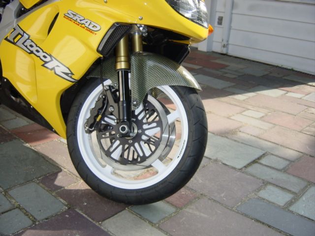

                      Brakes, one of my favorite upgrades
                      PFM SBK kit with Brembo radial

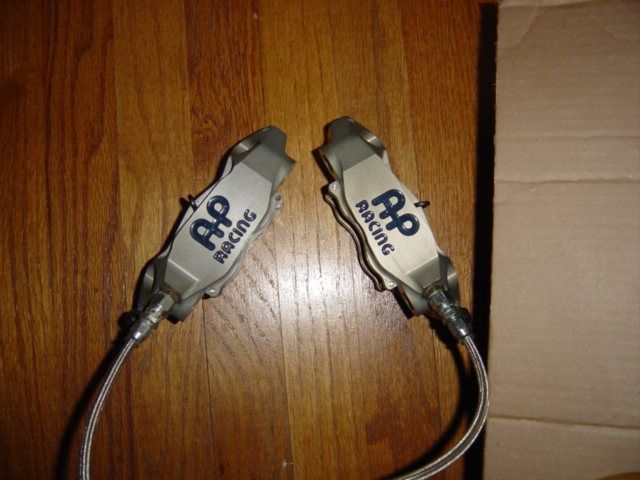

                      I wanted to switch to radial forks, but I hated the idea of giving up the brakes, then I found some AP monoblocks and an AP dual bore master. I still need to build the forks to put them on, but that means sending DannyNever a small fortune.
                      Maybe someday it will be done.
                          That's looking awesome Van! Not many of those AP calipers around are there? They've seem to put quite a bit more effort in the details of those calipers then the usual two piece it seems
                          Are those PFM discs noisy by the way?
                            Yes, I had the 2 piece calipers first, still very nice, but these are the SBK level caliper.(Brembo bought AP and stopped production of competing parts)
                            PFM's are not noisy in my book, you might hear it coasting to a stop a slow speeds, just a little ticking. I love the no button idea.
