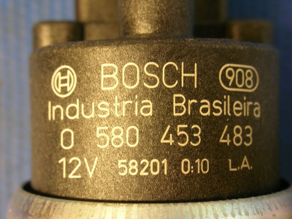

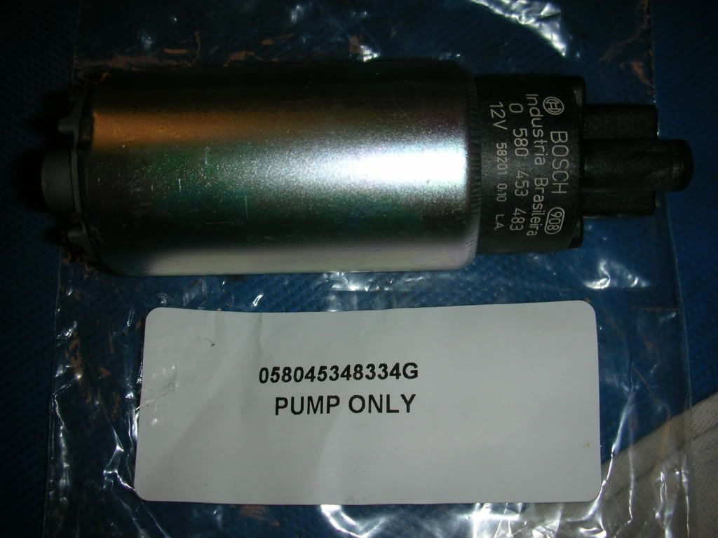

                        Or you might try this Bosch pump. Before the TLZone crashed, this pump was reported to have worked well in a TL. Not sure whether it was an R or S. I think they are the same, but check the parts fiche first.
                        This is the pick up screen attachment.
                        A few things to keep in mind with this pump and others like it.
                        It does NOT come with a pick up screen. Re-use yours or get a new one. Other kits come with screens, but sometimes they are too big to fit in the tank.
                        It comes with a plug-in pigtail for the electrical connection. You will need to add the ring terminals to the other end in order to connect it to the TL's fuel pump plate.

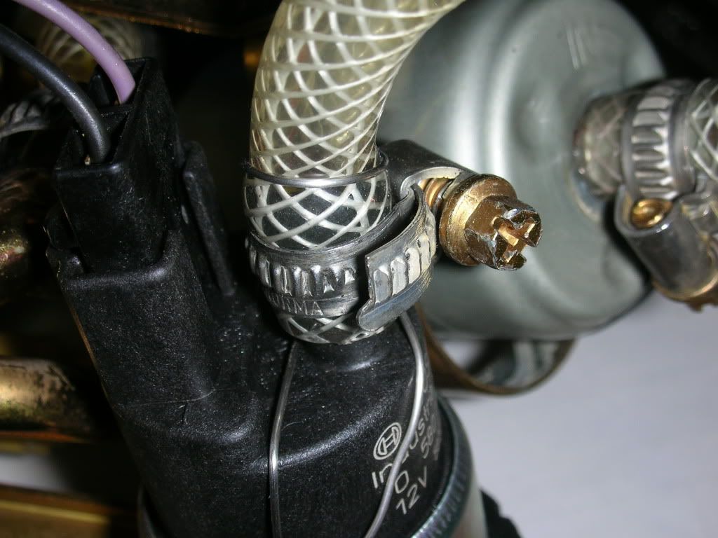

                        The outlet spigot has a very small tube ridge - for lack of better term. It does not allow the fuel line to grasp it securely - even with a hose clamp. (In the automotive application - 1998 Mazda 626 and many 1990's Fords - there is no need for the ridge.) Under certain circumstances it can blow the fuel line off. Safety wire it to keep it in place and you will have no problems. The photo below is from a Triumph Daytona installation, but you'll get the idea. I'm not an expert safety wire tech, but that fuel connection will not move!
